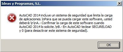

El problema es que en la versión "clasica" de BricsCAD no esta incluido el desarrollo NET, por tanto al registrar su licencia como "clasica" se ha desactivado el sistema de programación en NET y por tanto no se puede cargar ARKITool.

Hi,
1º. Open AutoCAD.
2º. Type secureload and after type 0
3º. Load ARKITool 2012

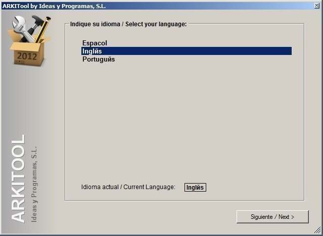

In the new version does not have a Russian and English language.

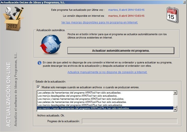

I user ARKITool 2012 downloaded 2012.08.22. And update it.

ARKITool is available in English, Portuguese and Spanish. We are working to translate into other languages.

I solved the problem with .NET -> I install ARKITool 2012 downloaded 2012.08.22 (from my archive). And update it.

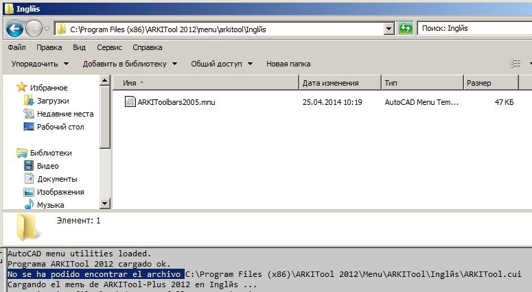

I do not see the English language.
